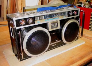

The C100F size is the sweet spot IMHO. This size allows the use of 10 inch drivers for solid bass and also allows for easier transportation.
Ira''s awesome RC550 stereo build confirms the use of 10 inch drivers in a C100F sized cabinet:

Yeah C100 woofers look too small for the box, IMO.
The skinny trim rings don't help. That's why TC999 and C126 look better IMO.
