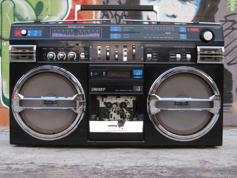

In my custom Unisef SZ-5000, I use a gouache mixed with water and used a sponge to work with the paint on the cone.
If make this in a sunny day, the results are SOOOO good.
In this pic, can see the "White gouache" difference between the cone, and the edges of them "in Original White" :yes:
Easy to apply, fast dry and no need much work to protect the parts as no need to be paint. ;-)
