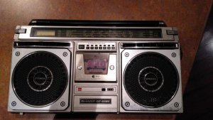

I had a walk round the recycle shop after dropping off the other stuff I didn't need and as I wandered into the electronics area I spied a few old Technics speakers, some midi systems and then sat all on its lonesome - a pretty tidy Sharp GF-8585X :-)
It was stickered as '$10, radio only works' so I grabbed it. Cosmetically it's good but needs a really good clean. The V aerial is bent one side, missing on the other so that needs attention. Radio works, all buttons seem to work, tuning / balance all work. There are no lamps lighting through which concerns me slightly and worst of all the cassette deck is totally inoperable. The eject is stuck fast although all other buttons work and the counter reset is missing and may have fallen inside. The deck seems to be constantly running as when power is applied there's the sound of a motor even though there's no tape in. This needs investigation I think ! Line in works but I haven't tested phono in (!!!!) or line out yet. Here's a pic....

I got into the GF last night to have a look see inside. It's actually quite clean and all the wiring was neat and tidy. I thought, due to the lack of some casing screws, that someone had been in there already and maybe screwed some stuff up but it looks pretty good. I freed up the jammed tape mechanism more by luck then skill - I moved a few levers and rotated the flywheel manually, at which point there was a movement and I was able to fully press down the Stop / Eject button. Play now engages fully and I've lubricated as many sliding parts as I can find with white lithium grease on a Q Tip.
I see from other posts that the rubber sleeve on the capstan can be troublesome but it seems to be intact on mine. More of a concern is the pinch roller tire which is rock hard and also the idler wheel tire seems very flat and hard - at least they haven't turned to goo !! I'd like to find a source for replacement rubber components like these, if anyone knows of one ?

Just made my first repair (other than freeing up the mechanism) - purchased a pack of nitrile O-rings and found one that fitted perfectly onto the idler wheel. Once play is engaged and the capstan rotated by hand, I can feel the additional grip of the new rubber now.
Next task is to remove and then attempt to rejuvenate the pinch roller - it's turned to stone !!

I found an issue with the deck where the stop eject wouldn't function properly but after a liberal application of lithium grease it seems to go great now. I'm thinking about changing the ff rew idler tyre too but not sure yet.
markoneswift
OK so my replacements parts arrived from my saviour in a far way land (aka Geoff 'Nikonfoo') so I'll be getting those fitted soon. I've got a pinch roller, idler wheel / tyre and tape counter to install and then a new counter belt to fit. The only thing I'm really in need of then is a right hand antenna stalk - anyone ???
markoneswift
Fitted the new pinch roller, take up idler and counter tonight. Interestingly, the pinch roller made little difference to the playback quality. The takeup reel idler, however, made a big improvement to play stability.

Got it from Nikonfoo (Geoff) - it seems to have very little wear or shine to it and the rubber is nice. The stability is fine, as in no audible wow / flutter, but only after replacing the takeup idler.
