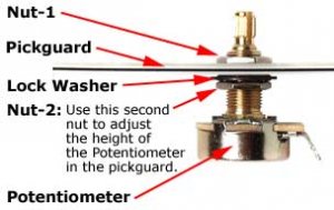

The spindle/axle of the pot has a lock on the groove that would prevent it push to the rear side. In the second picture on the right it clearly shows the lock on the spindle groove. All pots have that lock washer on the spindle/axle of the pot. After all one should not rest a box face down. Loading batteries can be done in standing position. Resting o a thick foam pad is not a bad idea because load can be evenly distributed.

Hi BBL48. I have noticed a few pots having the threaded screws securing it to a metal frame for support. I see what you are saying about the C-clip to prevent back and forth movement. Looks like in that pot it rides in a slot. That's a great design. I think they all should have that. Goes to show there are many variations on design. Some pots may be more resilient than others.
I noticed on the M90 the pot case shaft is threaded but they do not make use of securing it with a nut or washer or clip. They only use a case "cage" that is crimped to the board to help secure it. The spindle shaft goes directly into the pot from the knob. Unless the lock ring is inside the case of the pot there doesn't appear to be any protection for that model which may be why they are more prone to failure especially when they wear because the shaft will actually rock not only back and forward but left and right. On my parts box you can rock the spindle back and forth and in and out (being it only slightly...but still). This has to create more and less tension on the sweeper fingers and the mounts that secure them. They're only held onto the plastic spindle base by tiny (and I mean TINY) melted and mushroomed pins.
I think I'm going to play it safe on the M90 and load batteries standing up. What's the worst thing that could happen with this idea? Maybe the batteries fly out before getting the battery door on? Rather that then to even remotely or possibly damage a pot that you can no longer get. Every one of my boxes seem to have a different design on the pots so I guess this may be a case by design or specific model.
The nut on the potentiometer body doesn't protect the shaft from getting pushed in...... The shaft moves freely of the potentiometer body. The nuts only hold the pot and pcb secure to the chassis/radio case.
