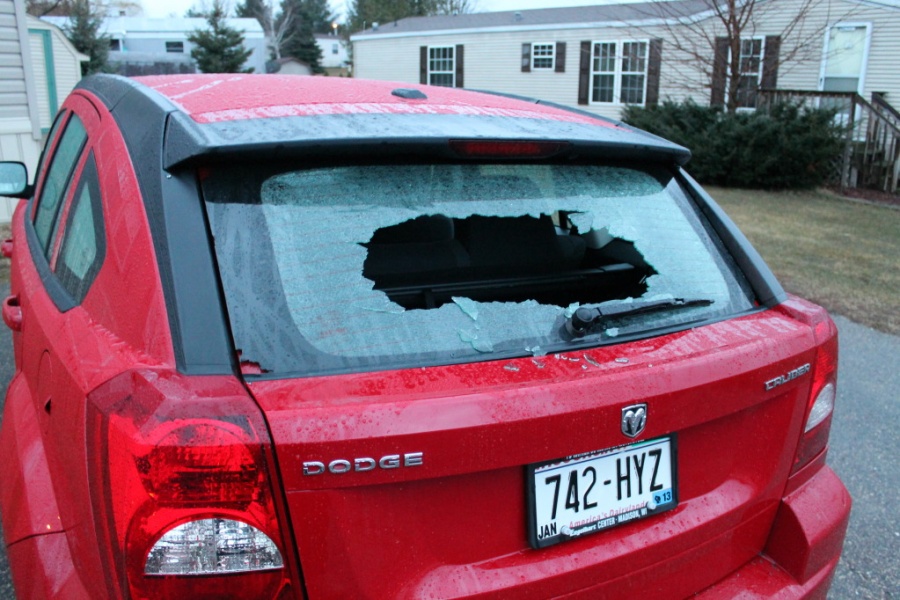

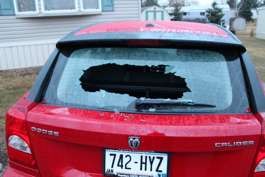

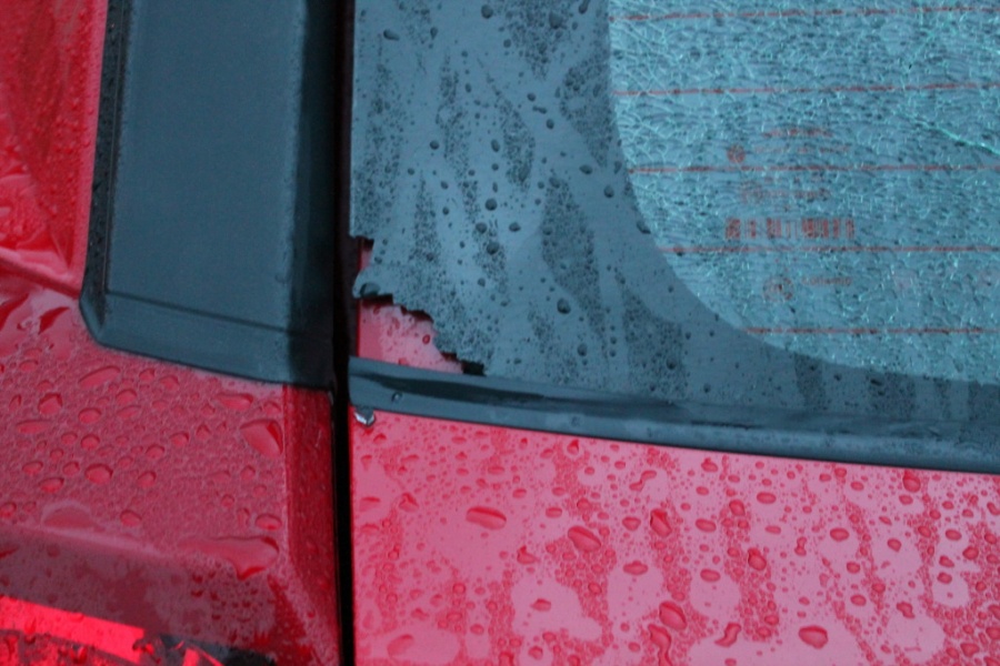

She tells me someone broke the back window of her almost new 2011 Dodge Caliber...... :huh: :dunce: :annoyed:
GRRRRRRR,at first I though someone broke it from the outside ,vandalism etc....... :bang: :nugget: :devil:
I didn't find anything stolen or broken besides the window and no rock or objects that were thrown either..... :hmmm:

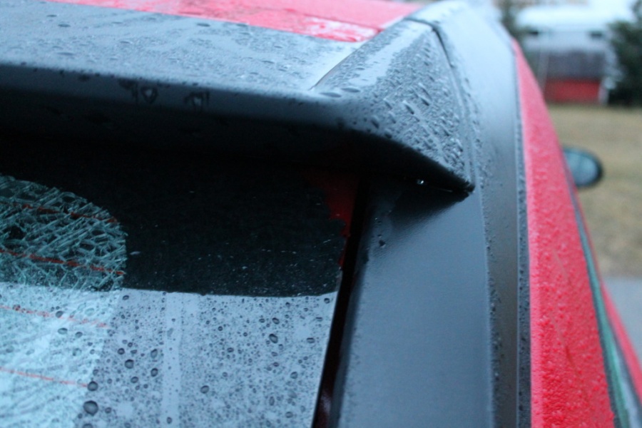

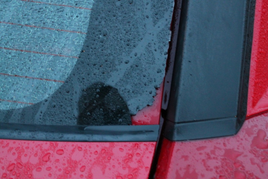

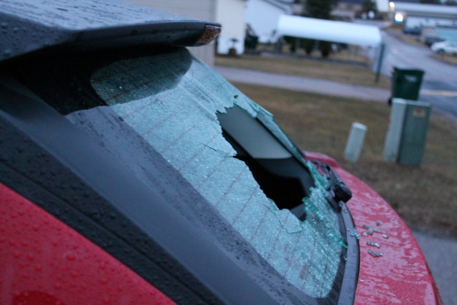

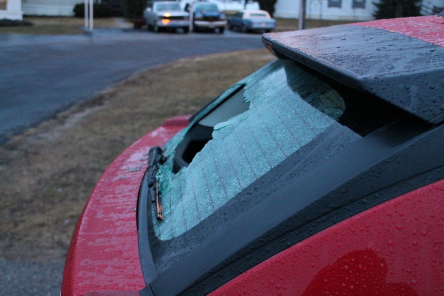

But upon further inspection from me and Baraboo's finest I think it might have blown out in the middle of the night.
All 4 corners of the window are broken like the middle of the window were bent outwards......
Any thoughts? :hmmm: :huh:

yes thats what it looks like a bad glass probably not tempered enough in the manufacturing process.. it happens hot and cold vibration all doing it process until it can no longer hold together and exactly thats what happens it comes apart ,,it does suck but hopefully the insurance can take care of that with no harm done... :-)
That is sad! :yes: :yes:
I've seen this happening when people try to fix the cut/break on the heater element of the rear glass. Basically resistance somehow builds up high and that area gets so hot, then uneven expansion shatters the glass. :yes: :yes:
Hope Skippy didn't try to fix a broken heater element.. :-D :-D :lol: :lol:

Definitely a strange event. Let us know if you ever figure out what caused this blowout... heating element, manufacturing defect, pressure from the outside, etc. Maybe the glass replacement guy will have an idea when he sees it.
