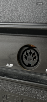

I have bought a 3.5mm to 5 pin DIN lead in the hope of connecting my Walkman to my Sharp GF9494 boombox, since the latter‘s cassette function has stopped operating.
There is a 5 pin din jack on the back of the Sharp but when I connect the two machines I hear nothing, even when pressing the Phono button on the Sharp.
Is it likely that the din connector is only for phono inputs like turntables, not for line-level inputs like the Walkman, and this is why I can’t hear anything?
Thanks for any advice.

The connector is marked with AMP , this is a line out .No sound in unfortunately
You can hook up an extra amp on it if you want more volume

Thank you for clearing that up. Do I have any way on this box to connect a Walkman apart from the RCA jacks, which do produce a sound from the Walkman but not a nice one.
You can try a 3.5 mm plug into the mix mic jack . it might only come out if the speakers in mono instead of stereo but it's worth a try. Also make sure the function switch is set on tape , all that does is make sure there are no other audio signals present.
