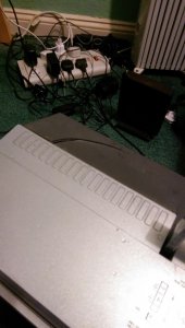

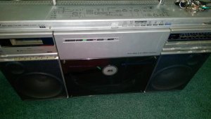

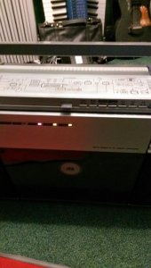

Just picked this up last night from a old chap that really didn't know what he had. Found that it was working, with just a missing slider, and a crack on the back.
Record deck working fine, tape amazing.
Only thing is that the buttons are stiff, and the play button for the record deck is not moving at all. Looks like I will have to take it apart. If anyone has any pics of that I would be grateful.

awesome, all you have to do is the remove the case screws ,open the tape deck and pull off the sliders ,pull the front off , no wires involved . the deck is super easy to get to and work on , the turntable remains mounted while you pull the front off , or you can remove it first ,either way works.
