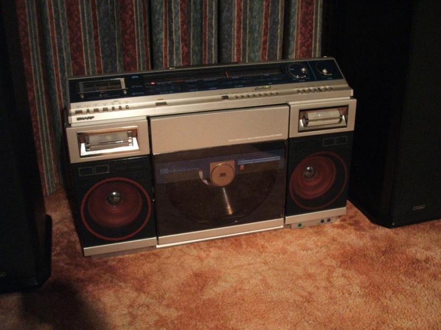

Found this poor VZ2000 on Ebay for a low BIN, it was in a bad way.
For the price condition I was surprised it even powered up, but it did.

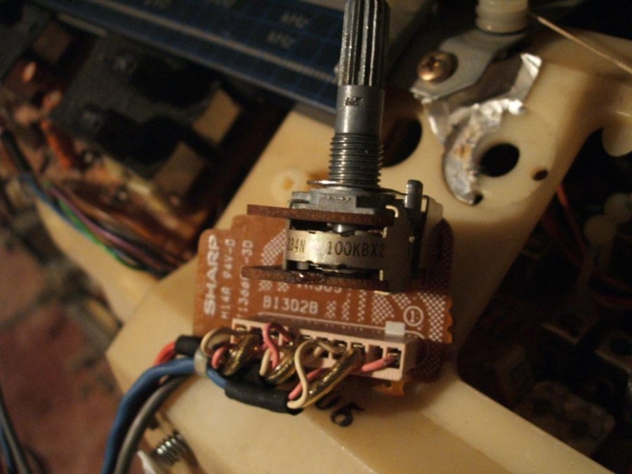

Headphone and mic board

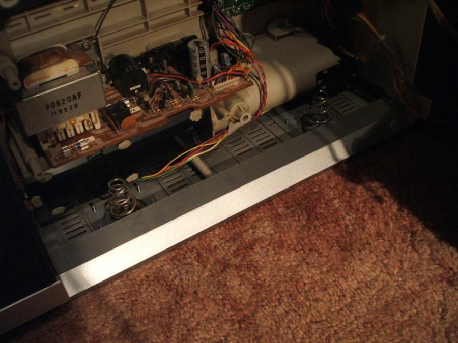

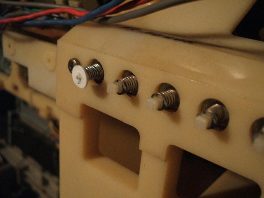

The other important things missing are the turntable suspension springs and mounts :'-( .

Big clean up of the front and turntable, taken the speakers apart and cleaned out a lot of muck.

What I have done so far.
Casssette deck rebelted and works well.
Turntable rebelted and adjusted tonearms now working, only one good stylus though.
Tuner works ok.
Not alot I can do with the back except paint it.
Anyway here's some pictures, I'll post the parts needed in the wanted section I hope to get this 100% functional
