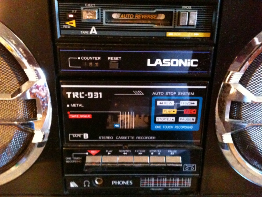

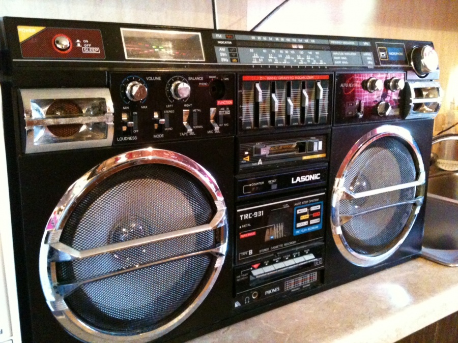

Got my 931 in the mail today, big shipping box arrived safely!!! Tested it out cautiously and was happy to have all functions working other than typical lower belt needing replaced, though it did play slowly. Does need the belt and Function selector knob and shaft, otherwise all working! It cranks out like I remember, spent hours yesterday blasting away, big grin! :thumbsup:

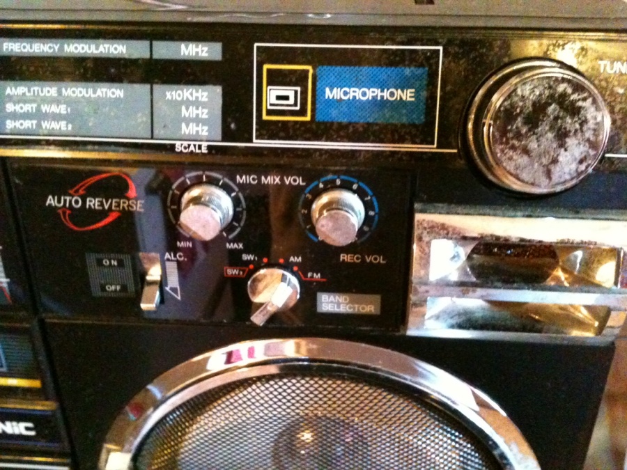

Cosmetically not perfect, needs a good cleaning and polish, but is presentable. Had it apart and back together already for a sticking Power switch and loose Loudness knob.

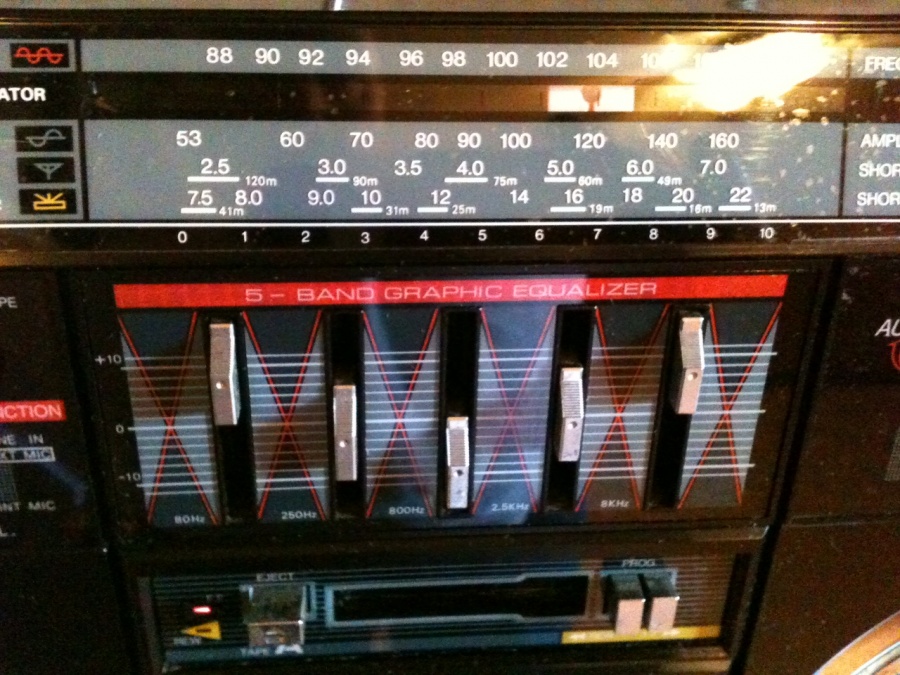

Haven't seen another 931 with the Power switch label like this one, since I had one like it. Anyone know what edition this is or is it just a different configuration?
Sorry bout the poor pics, I need to upgrade my iPhone.

Congrats on the 931 :thumbsup:
You dont see many with that tuner dial decal.

how does anybody know for SURE --
if thats not another version of the FIRST edition --?
imho --ALL those early square jobs were FIRST editions ( variations )
then - after that - came the second edition with rounded corners
The round corner was for sure the "2nd" edition if you only are considering the shape of the box.....
931 Editions are fun because there are SOOOO many!
All corners were square until the "3rd" edition came out.
1st edition:
Led's on right
2nd edition(s):
Led's on left, dual antenna, brown power button decal
Led's on left, dual antenna, yellow/blue power button decal
Led's on left, single antenna, yellow/blue power button decal
(these also had variations for the position of the headphone jack, not sure which for what without searching)
3rd edition:
Dual cassette, rounded box corners
4th edition:
CDX-931 dual cassette, CD player, rounded corners
5th edition:
i931 ipod dock
6th edition:
i931x ipod and ipod touch dock
7th edition:
i931Bx ipod and ipod touch dock, and blue tooth
