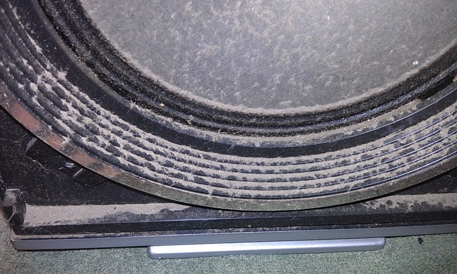

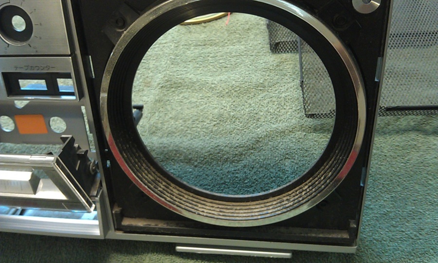

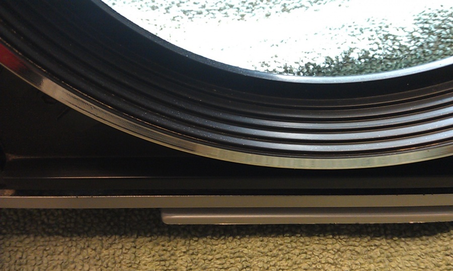

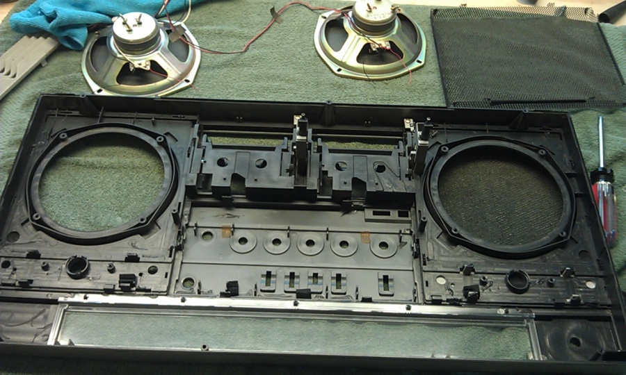

Once opened, this thing needed a full cleaning! Grills off, tweeter covers off, scrub in the tub cleaning!

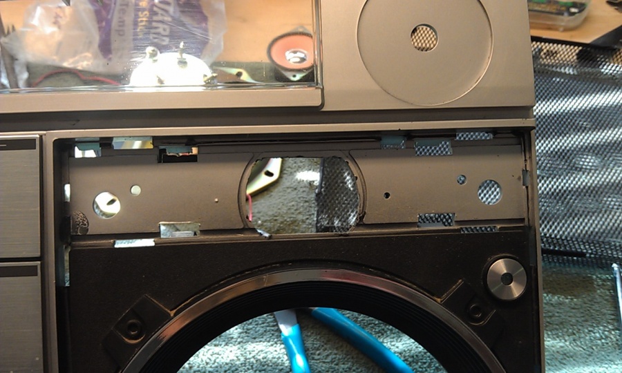

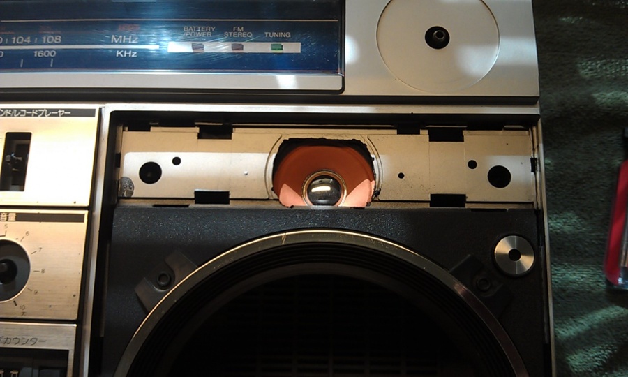

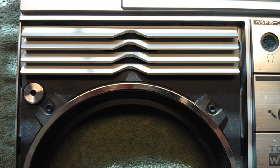

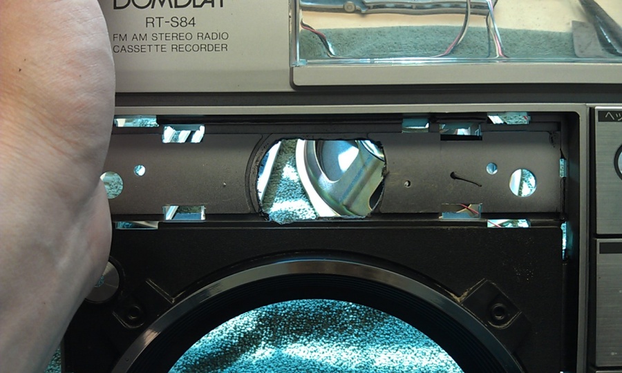

The front of the case already had markings for a tweeter this size. All I had to do was take a jig saw and cut the hole open behind tweeter grills. The interesting thing about the tweeter grills is they are louvers with holes the size of the new tweeter with black felt over the holes. From the front, there is literally no appearance difference!

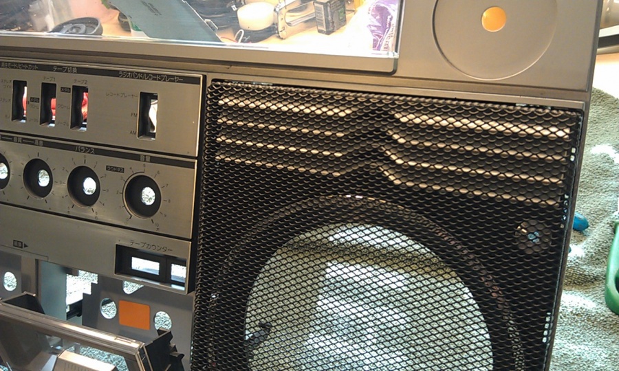

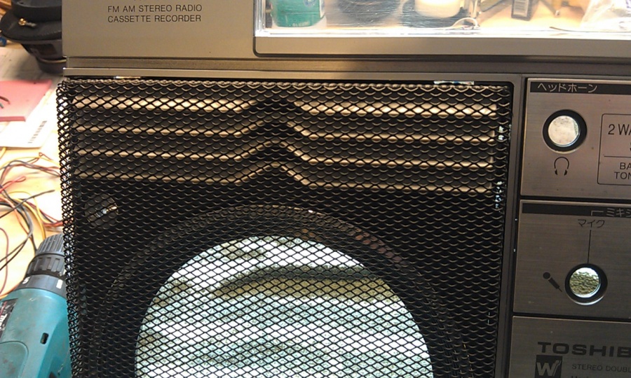

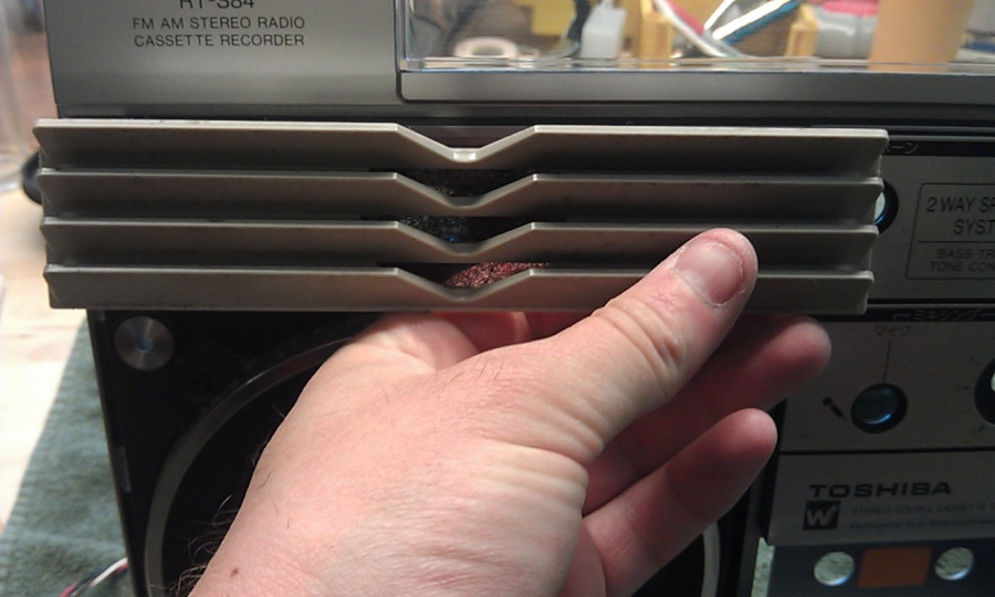

Here I was checking to see if I could point the louvers UP to get more volume....They would need modification, I left them stock.

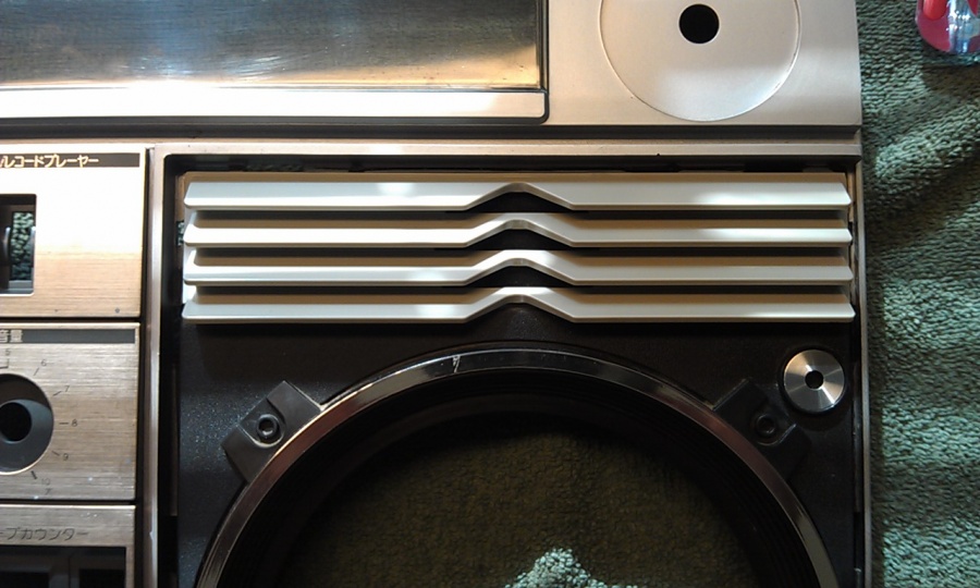

NICE AND CLEAN!

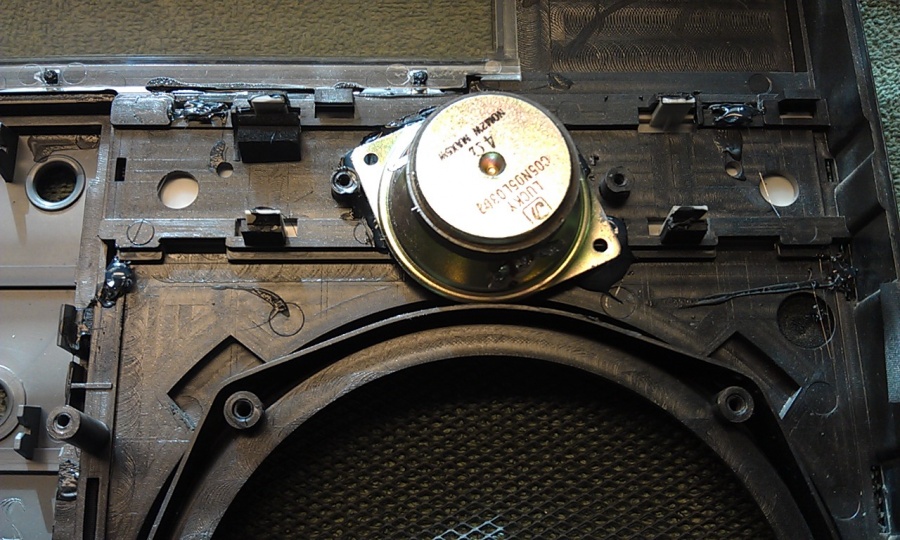

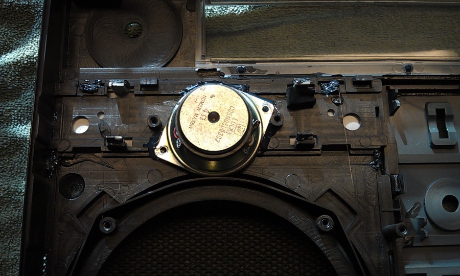

Here are the tweeters mounted....

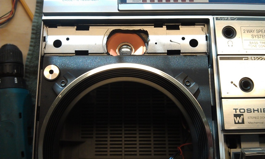

Here she is with the tweeter grills back in place! A piece of me thought about pulling the felt from the tweeter to hopefully see the beautiful Orange Lasonic Tweeters with chrome centers But I stuck with the stealth look :sin:
NICE AND CLEAN!
