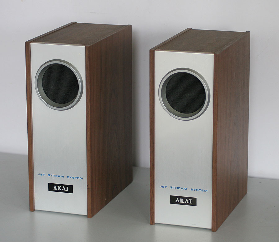

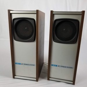

No... back in the late '70's and early '80's, many manufacturers made speakers with that tiki grill look... Sansui, Pioneer....
Oh. Didn’t watch the video. But that’s 30 seconds I’ll never get back, lol. They look homemade. I bet if you paint them yellow just right, they’ll look just like the 1-eyed minion.
Norm,
These are those Jet Stream Akai Speakers. Got this pic from Ebay
