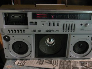

This nice Gem was my 1st lesson im painting,sanding rewiring and 5 months of long patients!
At tear down.Outer chassis cleaned &degeased with 409.Qtips,soft brushes and cloths. All keys,switches and buttons re chromed,5 1/4 mids rotted and replaced with Pyramid sealed Seizmic series midrange.8"woofer reconed.speaker covers also re chromed. silver Tamiya paint w silver chromate.

That is lot of work!
Looks great! :yes: :thumbsup:
"speaker covers also re chromed. silver Tamiya paint w silver chromate."
How did you do that?
I am interested in it!

It's one I've not met yet either. Sort of a Philips vibe going on but IMHO, it looks somehow better than Philips' Magnavox/Stella/Pye-branded three speaker sets and must be much less common in the wild.
Nice work.

I'm curious about the "Re-Bling" process as well... :hmmm:
The painting is fairly a patience and quality to key detail on any box.Which I took a great deal of time and a keen eye.To re chrome parts even metal or plastic.Be willing to want to spend a decent dime... A good plating place such as those that do automotive,hotrod or custom chrome,powedercoat etc.You can find a outlet to do plastic parts. I knew of a local shop in rod and custom plating that did some things in moderation.but again be willing to pay if you want a box as close to factory,or go with parts swapping with members... my plating cost for sliders,dials,etc $77.46+ tax. But my box I paid 300.00 firm.

I have always wondered what it would cost to re-chrome plastic parts. Yes, this is a bit pricey, bit if I had a super rare box with trashed chrome, I could see this being a very good idea OR if I had a radio I just loved and wanted it perfect....this is very reasonable.
Just my opinion but I think that box would look even better if you painted the area around the subwoofer that is now black. Change it to a lighter color to distinguish it from the speaker cone. Maybe just silver like the rest of the box, or maybe even red.

Real nice resto. CLEAN, CLEAN, CLEAN!!! Looks like a mini Toshiba WX-1

Yeah i was considering that at the time too. it has that classic folded horn look,but yes agree! :bow: Brotha. sub need too be seen in more movement. i am taking this in wisdom....
