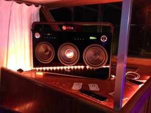

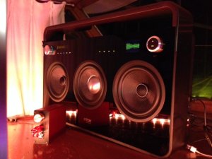

So... the volume control started acting up and I found that it seems to be an issue with these.

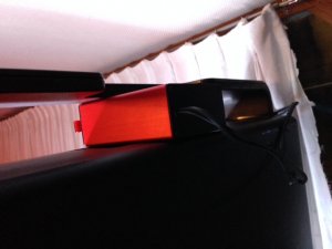

Because of the case design I opted to not take it apart for the repair. Arthroscopic surgery was required through the volume know hole.
I bought an aluminum case, switch ( because OEM pot has power sw incorporated ) and nice knob.
The sound IS BETTER than NEW, not sure if some how distortion was created, but now at wide open its so clean. or any other setting.
Just thought I would share an easy fix...
I purchased this pot: ALPS RK27112 Potentiometer 50K logarithmic audio taper pot.
