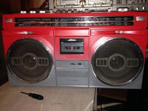

Any advice on stubborn screws that won’t come out?? I did a pretty spiffy paint job on a Sanyo M9935k but I should have tested it before I screwed everything back in. lol NOW I’m trying to unscrew the back again and I have 2 stubborn screws and I’m afraid I may have tighten them too tight and I don’t want to strip them.

Thanks for responding Lasonic. First I got myself in this situation because I took it apart to spray paint it and put it back together , screwed everything back in without making sure it was working first.
So I have 2 screws that won’t come out. The screw that’s in the battery compartment is slightly stripped, and the screw in the upper left near the antenna just turns, and turns

The JB Weld worked! But not in the way you think. I basically screwed the heads off both screws, pulled and pulled the unit apart. Luckily it was just a wire that wasn’t in too tight. But it’s good to go. I gotta a little touch up on the paint to do but I’ll just use the Montana markers for that.
Thanks for the help guys!!
