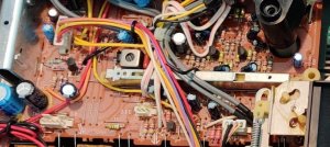

Another thing I noticed though, FM stereo light only comes on when tape deck is playing. For now, just having the deck, in paused playback, fixes the volume and stereo issue completely. Still sound like a record bar issue? Unfortunately, the record bar is almost totally blocked, on both ends. Hard to get in there to clean it.

You can spray with contact cleaner or alcohol. As the contacts are affected by corrosion and exposure to moisture over the years the only way to fix it is to remove from PCB and disassemble and clean by hand.
