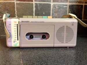

Hello! Throughout my childhood, I got a lot of use out of my Sharp QT-5(L) radio/cassette player. I wasn't sure if I still had it or not, but I recently found it.. I cleaned it up and put new batteries in it, but unfortunately, it does not work. Should I look into getting it repaired or do some upcycling? If I upcycle, what are my options? I appreciate the time and attention of anyone who reads this post.

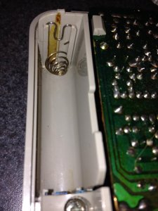

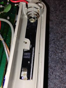

Here's what it looks like with the back piece removed. I used a flash in the closeups of the battery compartment, where I noticed some corrosion.

Well it seems that there is a fair bit of corrosion on the battery springs. I would start by cleaning this off, get an old toobrush to start with and clean off what you can. I did one for a friend last week and i sprayed some Servisol on the springs and it all came off pretty easily. I'm guessing you wont have any of this or anything similar. Just try to get off as much as possible to expose the actual metal of the springs, this may be enough to restore power on batteries.

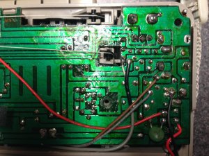

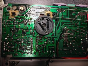

I was able to loosen the screw and release the clips, but something still feels like it's anchoring the board. I'm guessing it's the pieces circled in red. Here are some close ups if that helps.

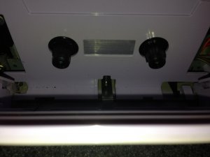

Looks to me like tuner string attachment is what's causing issue marked in red 🤔
Bad Boy Bill
Actually after a second look the tuner section should come out with board but the knob seems to have to be slid out in downward motion. Also deck door might either need to be opened or maybe removed 🤔

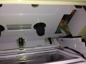

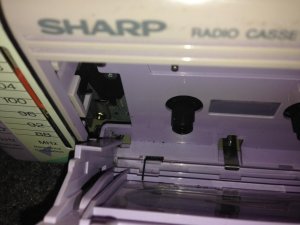

Here's what it looks like.
