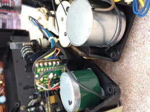

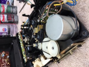

yes jimmyjimmy19702010 the belts are actually fine if anything to loose old age, the capstan tube that has been replaced was to long, I replaced the tube and belts but still exactly the same, looking at the deck I'm sure its got the wrong motor, the other 9191 I'm working on the motors smaller and has speed adjustment in the back of the motor the one iv got problems with doesn't,,, does anyone agree its possible the motors wrong, also appears to have a plastic arm missing that determines FF & RW god its a pain.
unsure but everytime I try uploading images it places them the wrong way around does my head in......,,,😕
PS the motor that has issues is the large one, without speed adjustment in the motor,,,,,

If you can make the auto stop work then I say the motor needs servicing. I think the motor is the correct one.

yep auto stop works perfectly, cheers guys will get deeper into the motor its doing my head in :bang:
I would spend a $10 on a new motor with a speed control in the back of the motor,the motor is housed inside of the larger housing so you do is pop the cap off the back and the motor is inside .

yes maybe right there all this messing around just replace it :thumbsup:
jimmyjimmy19702010 said:
I've never seen that style of motor in the GF-9*9* series decks I've worked on
well its definitely different to what i have seen on the 9090 & 9191 i thought its been replaced soldering looks not original :blush:
Did you solve the slow playback? My 9191 and 9292 motors looks the same as yours without speed adjustment. The 9292 also have the same issue with slow playback :huh:
