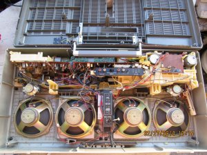

Use Deoxit Faderlube on pots and see if it works well to clean and lubricate it. Opening the pots, taking it all apart and cleaning is not an easy task. Its time consuming and needs lots of patience.
