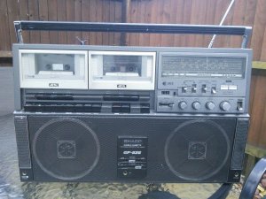

Hi all just bought an gf 525, good working order, but has the dreaded paint spots, any ideas of how to get rid of, cconsidering an total respray, any one knows the right colour code?

Depends how bad they are ... if paint is still stuck on then I usually find baby wipes get most marks off - I sometimes wrap a baby wipe around a plastic spatula (to ensure it does not add scratches) and go very slowly and carefully at chipping the paint spots off one by one and then wipe over again with a new baby wipe ... it's amazing what muck they will shift.
If the paint marks are off and there is still shadows where they were, then you might need some other method of cleaning the coloured plastic that I am not so familiar with :-)

Strip it, soak the casing in hot soapy water, then use the edge of an old credit card...works wonders :-)

Just make sure you get all the water out of the screw holes. Its a bitch and it never seems to come out of there. You don't want the screws rusting. I've left soaked boxes out in the hot hot sun for days and there is still water in those little holes, eventually I use an air compressor and it is still a biatch to get out!!!

Cheers will be giving that a try if can't get it all of with the baby wipes, amazed how its doing the job pains taking tho, but great ideas, cheers guys...
