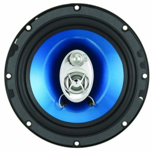

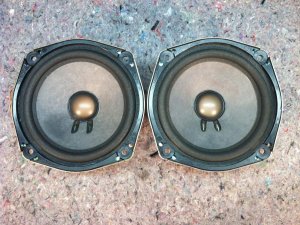

With some helpful advice. I'm gonna replace all the speakers and soon send out the originals (when I find the person and time) to be redone. These are the replacements I got (after) I grabbed a set off 777 speakers. Bose. See pic.
also, the 777 replacements as well (which I'll likely sell for what I grabbed them for) Can I test speakers with a 9 volt battery? In addition, When swapping replacements. Do I put something between the speaker and body of the unit to deter vibration? :angelic:

trust me on this...use the 777 speakers as your best replacement they are the same speaker that came out of the 1000 if you would like i would be more than happy to spray the 777 speakers white for you all you will need is a smaller dust cap for the outer woofers very hard to find replacements for these a lot of issues arise ...if you can find a set of gf 8989 speakers and use as your outer ones!!!pm me if you would like more info....jimmy :thumbsup:
wolff3012
GF 8787 speakers (they are white) are also great in a GF 777 !!! :-)
Together with painted HItachi 3D80 speakers, you got a killer GF 777 :yes:
