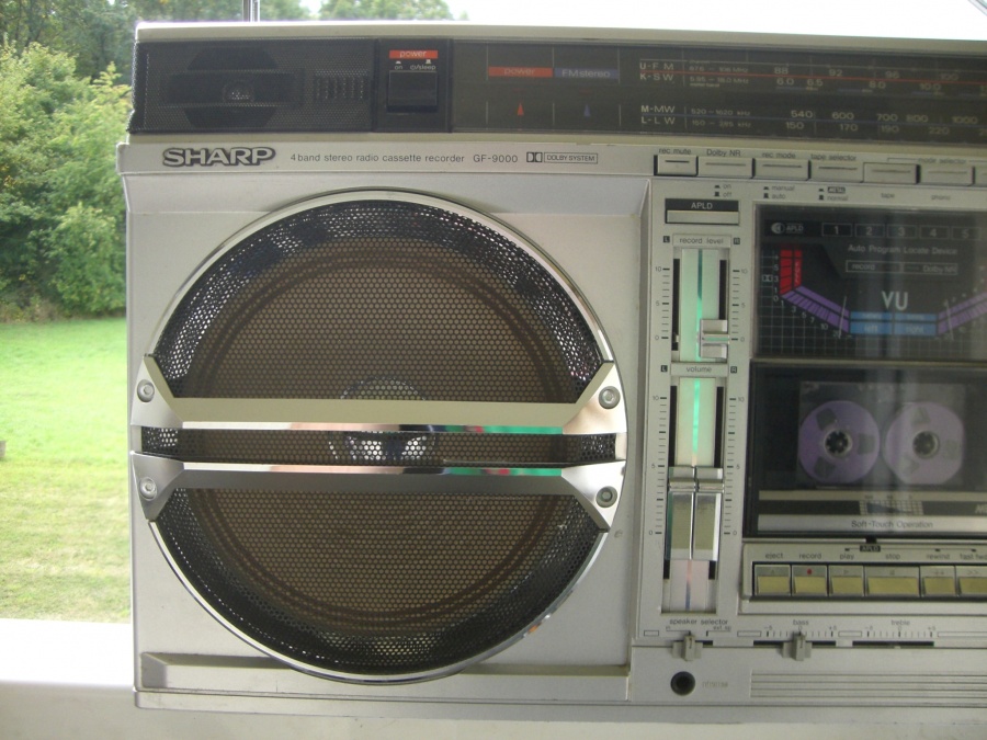

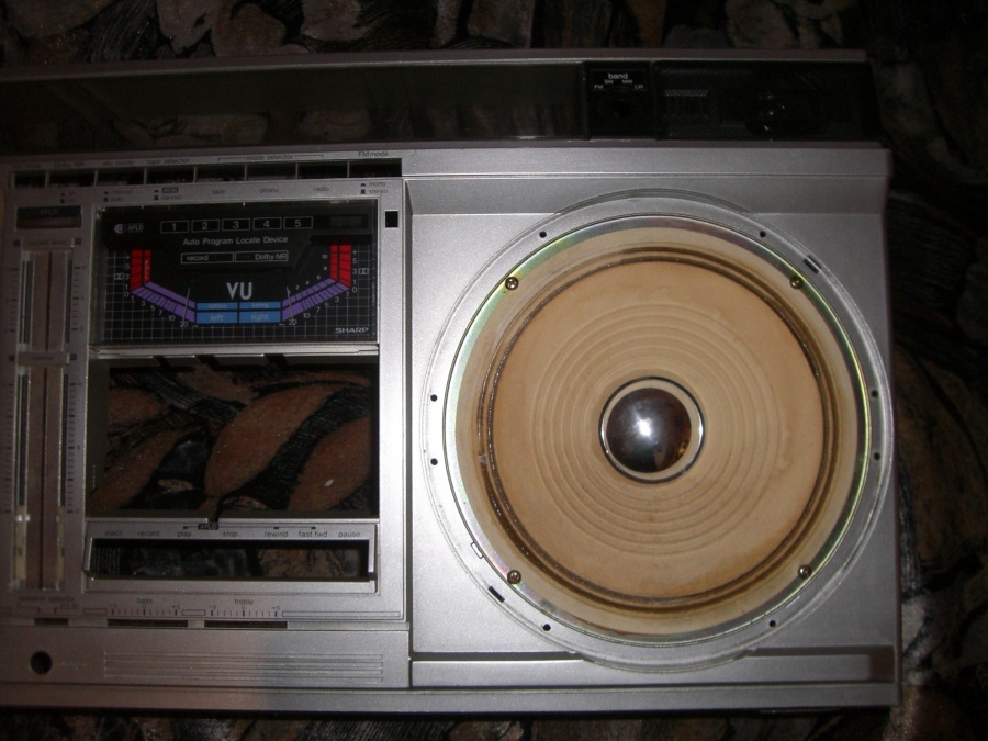

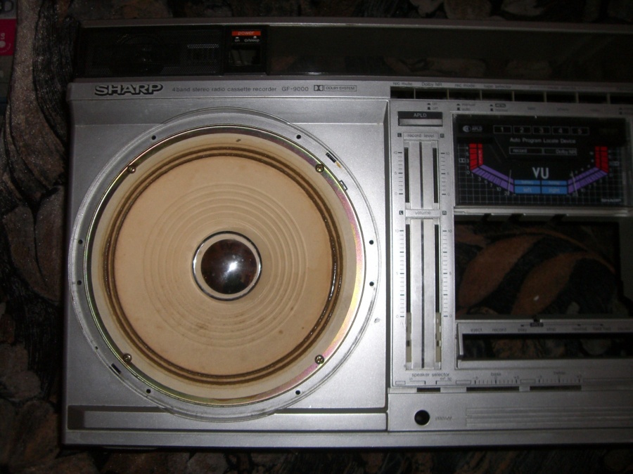

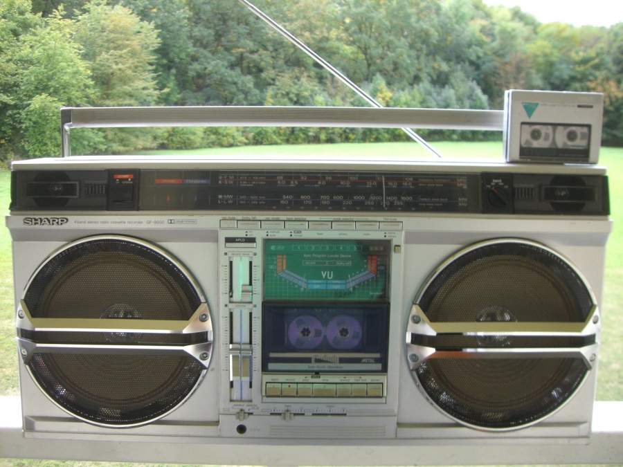

Now I have the second Sharp GF 9000 this was in a very bad condition because I had to clean a lot as you can see it has paid off, unfortunately 2 important towers are missing for the slider, and he only goes to battery of him trying to operate on AC power led to the total failure in the apartment oh w
ell one can not have everything such a factor is quite ok :thumbsup:

:eek:fftopic: When bleaching, do you put the bleach in a spray bottle and spritz the speaker? :huh: I have never tried that :no:

Yes Chris. Put it in spray bottle full strength. Spray over speaker but don't soak it. Put speaker in up position so no bleach drips into magnet/coil. Let sit for few minutes then blow dry low heat. Repeat if necessary. ;-)
