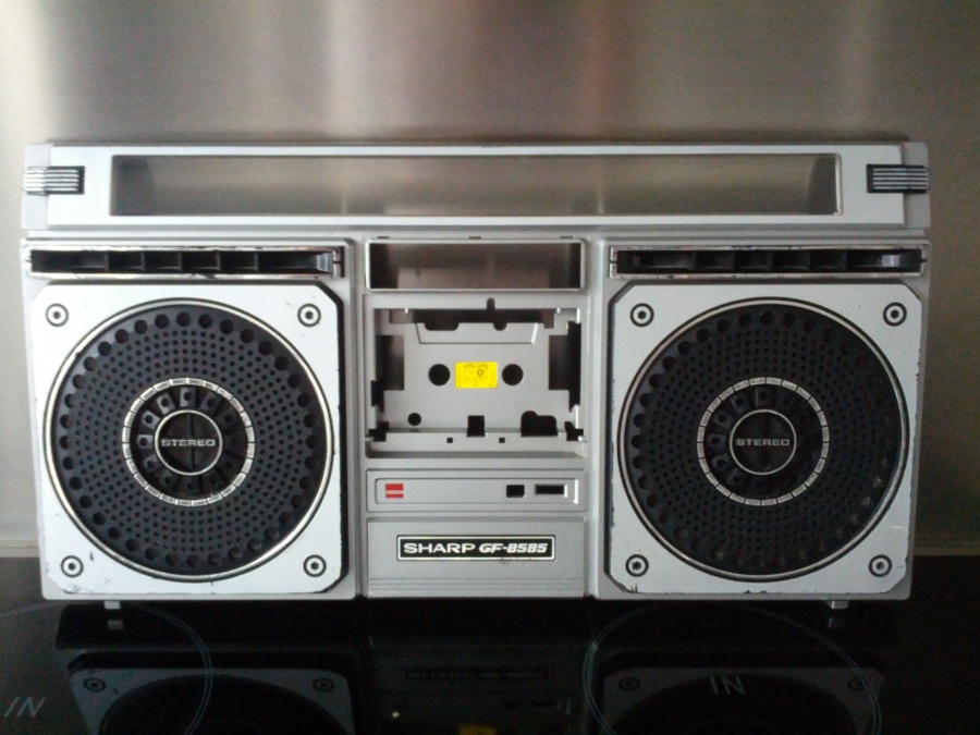

Latest addition to my collection, a Sharp GF-8585.
I would like to get get some hints and tips (newbie) from you guys on how to restore and save this bad boy :
# paint and plastics are dented, chrome gone etc. - what is the best way to fix this.
# tape deck is hungry when playd ;-( and quits almost directly. FF and REW work.

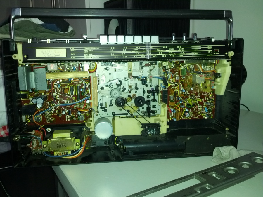

# There's some "woodwork" inside - what does this do?? looks like somebodies been inside before..... :-)
# Anyone in possesion of a (service)manual that u would like to share?

The tape deck is an easy answer...every GF seems to have the gooey capstan issue...theres a little rubber bit around the capstan shaft that needs replacing as it goes to mush. If you search the forum you'll find its very common and there'll be tips on how to do it....done it numerous times myself and its not difficult :-D Might need new belts as well but again its not difficult....all of mine have needed the capstan doing but the belts were fine.
I've no idea what the hell those wooden bits are for!! :w00t:
If the paintwork and chrome is knackered then I'd do a full strip down and respray :yes:

Your photo is so clear that I thought I will show you what Northerner said about cassette.
There is a 5mm dia rubber wheel inside the capstan housing that drives the white plastic take-up wheel that you see.
Here is a link in s2g http://www.stereo2go.com/displayForumTopic/content/193392314112241804
