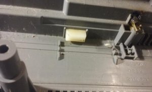

Got it, sorry bout that. I'm not the most well versed in the breakdown of these boombixes, just know the basics. What is this thing? The little white plastic block, is it just a buffer/cushion for the internals?
