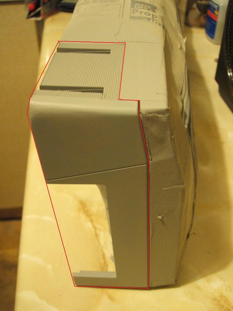

I have now primed the repair, not 100% happy, profile not quite right but the shadow and camera make it look much worse than it is. I'd appreciate any comments. I could try and improve it, but I could make it worse. Only the area inside the red line is primed the rest is masking.
stormsven
Splendid work mate :thumbsup: . After month you'll forget about this bad experience and all left is ..... :breakdance: . Well done!

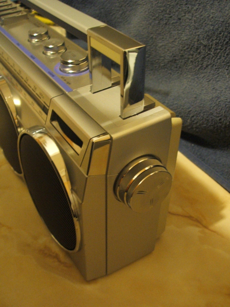

Ok I have finished the repairs :-D
Thanks for all encouragement and nice comments it really helped.
I'm actually now very pleased with the result :yes:
So here it is.
