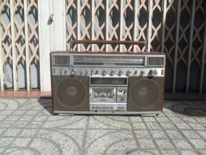

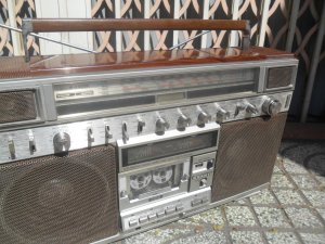

I recently scored a Sanyo M-820K in rough condition. Despite the bad condition, nothing was missing, no cracks or broken parts.
I did some test and this is how the box is working:
- Radio and Phono functions work
- Tape and line -in does not work.
- Both speakers work . sound comes out at normal listening level but Can not be adjusted.
- Both balance and volume knobs has no effect on the Volume out. Treble and Bass knobs work normally.

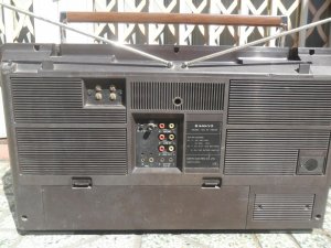

I noticed that there're three functions beside the Function Switch: Phono/Radio/Cassette. NO Line in listed.
So I have a question need you guys, who ever own this model or know about it:
- How is the LINE IN supposed to used on this model? Just hook up the RCA to the Line In ports then switch to PHONO mode and play music; or we have to switch to TAPE mode and then press Record button as like in some old 70's boxes?
Thank you very much!

Thank you all for congratulating. I bought it from a scrap dealer, who did sold me some boxes before, like my National RS-4250, RX-5600.
This box sound really good on Phono (2 RCA ports) with volume on my phone turned extremely low. I know that's not the right way to use this Phono function but I can't find a Line to Phono Attenuator to buy so I'm looking for help to make use of the Line in function.

Hisrudeness said:
You tried the middle set of RCA 's on the back?
Yes I tried it with function switch set to Phono but no sound come out.
I would try the microphone inputs I use this on several of my boxes and have no problems .
Hisrudeness
You can use one of these on the phono ports with your phone and it will smooth the sound out.
If not then send the box to my house asap. 😎
Thanks, I'll try if that work :yes:
My hobby mate think that's the only way to use this Line In, only for tape recording, there were no CDs in the 70s - beg. of 80s yet
hence no need for the Line In with a separate switch position.
Yes, I'm going to think so too.
