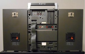

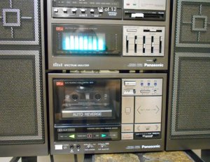

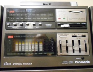

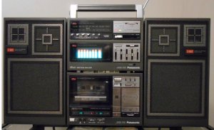

Heres a pics of the box for those lest familier with it
