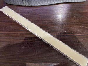

Not sure that the restoration kit will work, as think the plastic may be too far gone. Have already tried to rub down the tape door, but didnt make much difference, but will give it another go. I have attached a photo just to show how bad it is.
I will still give it a go as don't have much to lose but thinking my only option will be to find a donor.

Jeez, wtf happened to that window? You can't see throught it at all? Must have been internally damaged by the sun.

yes, I think the machine has spent a very long time in the sun. The box is in a very sorry state and very dirty and greasy. thankfully a very deep clean seems to be bringing much of it back however I have played around with the windows and there is no bringing them back life I think.

I believe that the discolouration is full thickness or certainly much deeper than the surface layer.
