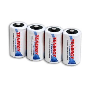

I'm considering some 10000mAh Tenergy Ds. Does anyone use them‽
http://www.amazon.com/Tenergy-10000mAh- ... 402&sr=1-2

When I finally buy mine I'll get the tenergys or these http://www.batteryjunction.com/tpeh-td12000.html
Batteryjunction sells some nice "smart" chargers that know when the batteries are full. It makes them have a longer lifespan.

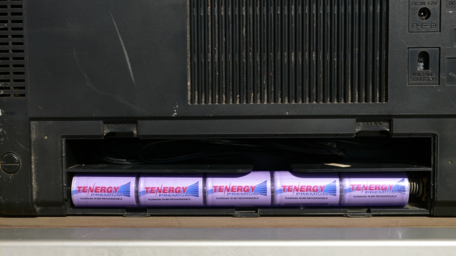

I bit the bullet and purchased the Tenergy Ds at the top of this thread. It took 12 hours to fully charge the beasties to 1.383 V; they arrived at 1.22V but wouldn't operate my 931 MK III. I used this charger although smarter chargers might work better.

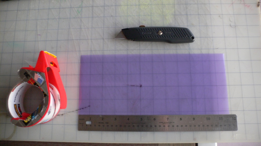

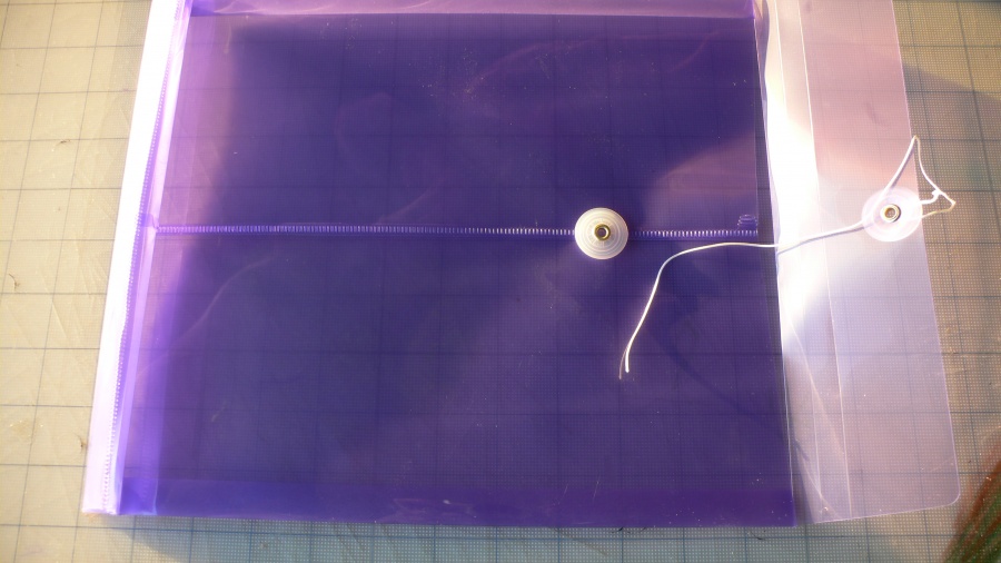

I also made some Gluecifer sleeves to keep them in check:
Sacrificial Purple Plastic Envelope
Operating Theater
Success! :-)
