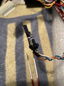

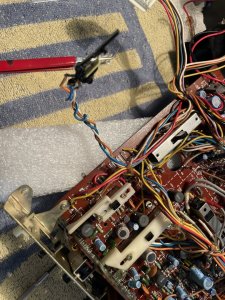

I put everything back on the chassis and not in the box, and a small copper piece (it looks like a flat spring) falls on my work surface!
I try and except the power supply quiet good,
no more sound!
no sound in the speakers or in the headphones
only an electric background noise.
no tape, no radio, no aux no phono.
I lost the auto stop, the mms
does anyone have any idea!
