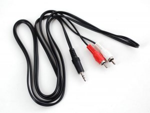

Ohhh, that my be the problem..........
this is the one I've beem using

I tried using an rca input like that too but didn't have much success. Get yourself some 3.5 all around cables and you will get the results you are looking for.
Okay, this must be the cable.

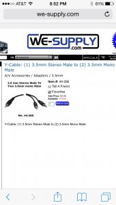

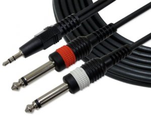

No that isn't! You needs cable that has 3.5 connections on every end. This is what you need:

I also have the one justcruisn posted and it works ok. It has a sleeker design but the connection is better with the Y cable i think.

They are in fact AUX inputs and the L and R jacks are MONO 3.5mm - 1/8". So you need to convert your MP3 stereo output into separate L and R mono inputs.
