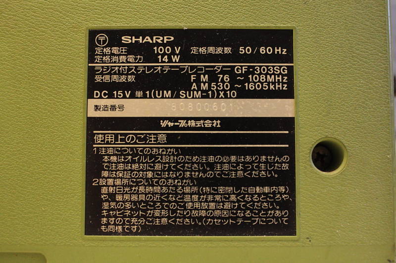

Thanks for all the information, guys. The 9191 that I'll be getting draws 14W and is a 15V machine. So, it looks like swapping an 8585 transformer into a 9191 will definitely not work. :-/
Bobby my GF 9191 draws 35 watts at 15V ;-)
baddboybill said:
OH :-O :-O You got the green chinese box... That is very strange about the watts... They are litterally the same box minus the transformer :hmmm: :hmmm: Maybe Norm could shed some light :-D
