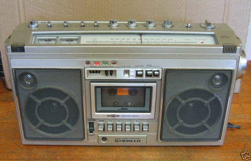

Today pick up at my local street market ,very productive week !!
Radio and line in works , tape dead ,found the belts in the batery compartement ,and aerial is bronken
overall is in a good shape ,need good cleaner

today found a somme insues ,right channell not sound in "stereo" and "hig filter" mode ,in wide mode yes .
kingrat2010
:thumbsup: ok i have the exact same box which had the exact same problem, deoxit didnt help at all, in the end i just needed to plug something in the line in and play a little bit with the connections
anyway congrats and good luck with fixing the right channel :thumbsup:
chevyman-uy
Today fix the problem ,tons of contac cleanner solve the problem , i note the material anti dust in the switch
is completely disintegrates need to put new ones in all .
tets the input line, but you hear very little volume and heard the radio background ,y try to more cleanner the rca .
