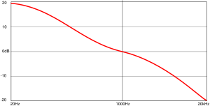

Phono inputs are expecting to see inputs in the range of millivolts, line levels are much higher than this.
Also, phono input stages have RIAA equalisation correction, to restore the frequency curve of the original source material.
Overdriven phono stages sound horrid, distort and clip. There may be damage to the input stage too.

Phono in is designed solely for turntable cartridge levels, also the eq curve is COMPLETELY wrong - the bass is boosted and the treble cut in accordance with the RIAA spec to allow for the correction of the special eq used by the cutter when a record is mastered/pressed.
The adapter is the way to go, works well. :cool:
