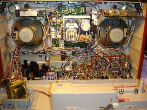

That is correct! So far I've have never seen so packed with components and build quality like RX 7200.
See my RX7200 interior
