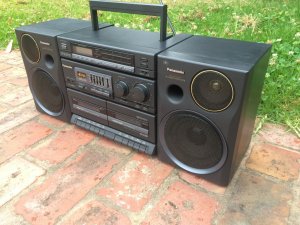

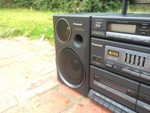

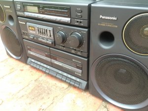

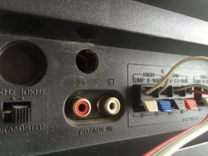

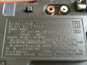

This thing is a power house 60W. I couldn't find the exact specs for this model but it has the BI wiring and 4 amps with 4 speakers. Not vintage sound but loads of Bass.

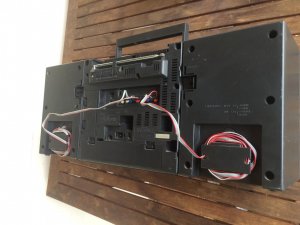

This has the factory RCA line input

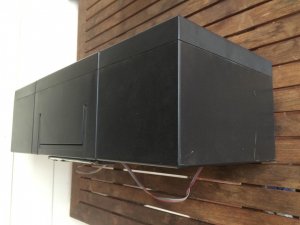

The cassette mech is delicate be careful when disassembling. Turn the box upside down and lever the bottom out first to clear the plastic buttons from the metal levers. Must be reassembled same way.
The main drive belts are flat they were in good order as the auto stop was functioning correctly

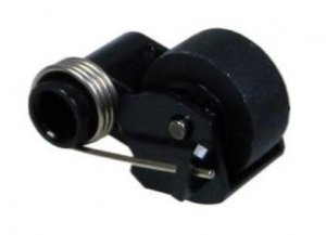

The problem with this one was only the pinch rollers they were like a jelly baby. This is unusual as these normally go hard, probably because it's made in Singapore. I replaced these with new ones (knock the pin out) cleaned and adjusted heads.
There is also some handy volume trim pots for the left right channel for each of the decks. You can push a little gain on these and get you balance as well.
I found a picture of the Pinch Roller assembly, you can just replace the rubber roller.
