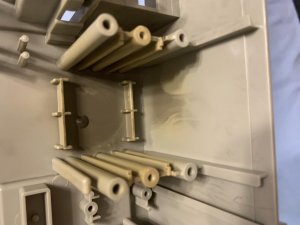

This is my first time posting on this forum and I’m looking for a little help. I recently picked up a Panasonic RX-5010 from an estate sale that is in impeccable cosmetic condition. The radio does work, but a belt in the tape deck was broken. Decided to take it apart and clean it real good while replacing the belts. Unfortunately one belt completely melted and was a gooey mess on the circuit board. I also noticed that the power supply seemed to get a little hot at one point discolored the surrounding plastic in the case. There was also a fair amount of “soot” inside the case as well. Is this normal or something I should be concerned about? I’ll post pictures below. Pictures are after I washed the case.
Thank you!
