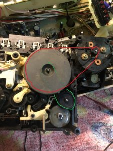

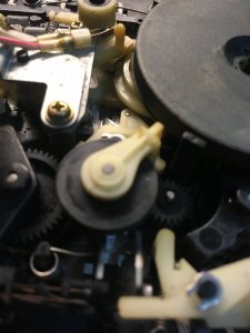

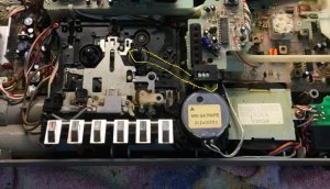

Hello. Does anybody know the belt path for the Panasonic f35? I thought I had it but now see this one wheel and not sure what belt goes around that. It’s the white wheel in the last pic. It has grooves for a square beltAF8681DD-84F3-4C66-9F2F-CC7D90E1F8CA.jpeg1DFC5A4E-606B-4AED-9897-50E9A6393D77.jpeg9FE90A39-60FA-4A89-A39E-F8E0B93E4F82.jpeg

Thanks Raheem. That’s what I was thinking but then saw the white wheel with a groove on the side that looks like a square belt goes there. Guess not. It looks like my motor is not spinning so need to find a similar one before I rebelt
