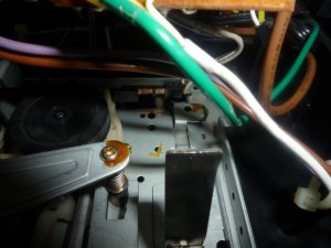

Hello,
I have just received it in very good condition.
But the contact in tape deck makes a little spark when it closes and there is a short big noise in the speakers. Do you have a solution to reduce this noise ?
Best regards

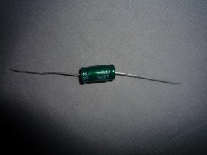

Hello, I have this but it is no ceramic I think. I will look for ceramic capacitor but can you give value ? (V and uf) ?
I also have this : polyester mylar 0.015uF 15nF 100v 5%
All I can suggest is try one and see if it helps, then go a little larger if necessary. Is that an electrolytic? It's probably too large. The polyester one might be better.

I've tried different capacitors but no result. I have another problem : the sound of this boombox. The trebbles are like a porridge ! Horrible, it is hard to hear clearly cymbal.

Instead of the capacitor, you can also install a diode too, but that generally is to reduce arcing when the contacts open.

the contact is clean but perhaps it is worn out.
