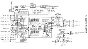

So I bought a Toshiba Bombeat 18 (RT-S893) and have no radio at all, no FM or AM, just a pop when I switch between them or to the radio. I'm kinda guessing the AM/FM IF Chip (TA7614AP) since neither works and I have no tuning LED activity.
Here is the block diagram.
Any other ideas??

Well my original assumption was correct, replaced the TA7614AP and lo and behold I have radio! Was just lucky I could find the chip to replace.

As to figuring out this problem if you look at the block diagram you can see the AM and FM reception pretty much follow separate paths to the amp (Which works since AUX in works) except for passing though the TA7614AP. Since I had no audio at all on either band (Not even Hiss) that lead me to believe that was problem. Also if the problem occurred after the 7614 I would have still had a tuning light as it controls the activity of the tuning LED.
It's kind of like being Sherlock Holmes following the clues led to the answer, sometimes it's not as easy, it could have been a passive component, or a bad solder joint, but again from experience I looked over the board and visually everything looked good and did some quick probing with a multi-meter which again led to the chip.
