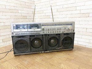

Anyhow I just scored a quite mint GF triple 9 that I am taking a chance on as it is untested. However it was one of the nicest ones I have seen in awhile so I decided to pull the trigger on it. It seems that when looking at listings of these particular Sharp's it's uncommon to see them completely not functioning with the usual problems only consisting of a non functioning tape deck or scratchy, malfunctioning pots.
So I wanted to ask here if there were any common quirks or things to watch out for on this model when going over it? Is there anything I should check out before applying power to the unit? I'm not new working on stuff like this but I am completely new to this model so please forgive my ignorance here lol.
Next thing to discuss is the model differences. I understand and have read previous forum posts on the differences and understand that most folks seem to think that the 1000 has better speakers. I understand all the obvious differences like dust caps, speaker grilles, VU meters, and colors but I was mainly curious about the specs here. I noticed that only the triple 9 and the 1000 has the 4 different jacks on the bottom middle front VS all the other models that only have 3 jacks? Then I noticed that the 1000 states it uses 32W VS all the other models including the 999 that state they use 28W. Would that be from the better speakers used on the 1000 or is it possible that it is using better amps? I have also heard that the GF1000 used a better case/chassis? Or that is was reinforced more? Does anyone have any proof to this? And being that the 999 is so similar to the 1000 does it share any of those features too?

I guess I'm just trying to figure out it the triple 9 shares more in common with the 1000 or does it share more with the 707 or 909?

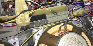

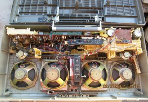

Regarding chassis bracing, here are two photos. The first shows the interior of a GF777. Notice there are 4 screws for each woofer, like in every boombox. Now look at the second pic, from a GF-1000. There's a metal brace across the top edge of the speakers. That's something the GF-777 doesn't have.
Your 999 might have that brace. I don't know.

When I opened it many years ago for maintenance, I noticed it had metal brace across the top edge of the speakers.
Most models (except 676) have such metal brace.
