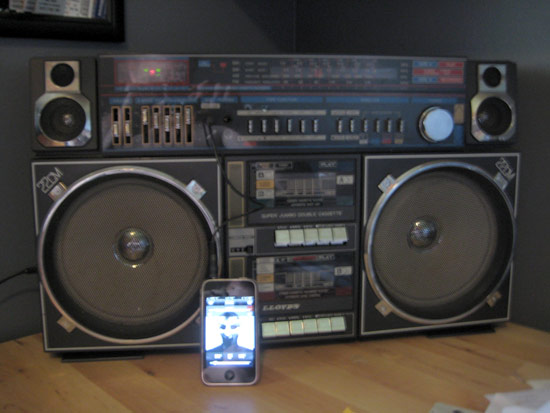

Oh, the mic jack should work fine. Just don't have the ipod volume set real high as it will clip and get ugly. I have my iphone at maybe 15% volume and it's all good. I'm doing just that on my Lloyds right now, rolling with 22s (cm that is). Sure, it might be mono on some boxes and all, but I'd rather have mono and thousands of songs on cue vs just my tape collection and crap broadcast radio.
I just have the mini mic jack to the larger, but that would of course vary by your radio's inputs. Of course you could to rca's or whatever source you want if you have the adapters.

:drool: i want your PT003 - been looking and wanting one for years :'-(
