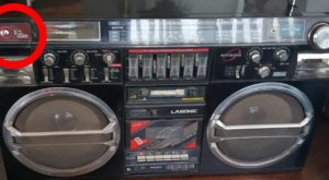

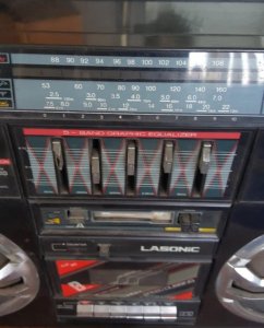

I found this TRC-931 today. But I have few questions.

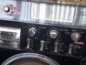

Why the body color of power button is other than usual?

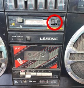

Is the FF RW buttons on horizontal deck replaced?
And Is the sticker on deck B original? or it is from another boombox?
I cant found any similar images to check it out.

I would call it an early variant of the second edition 931, this would be an early production model sold before the start of the production of the more familiar second edition.
Those black cassette buttons look like they came from a car stereo , it would have silver buttons.
The cassette door cover on the bottom cassette player is not the original one.
I'm guessing the cassette door is not original to that box and the FF/RW buttons look to have been replaced, but Floyd got it. It's an early 2nd edition 931:
trippy1313
Yep yep. 2nd gen for sure. I agree the upper deck keys are wrong and lower deck door. Still worth getting if it's a good price!!!
