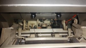

When closing, the door of left 's deck does not lock. No noise as for right's deck. See video

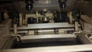

The only difference is the position of a spring inside the cassette compartment. See photos
How did those springs come out from the holes? Now you have to remove the front side and align the door correctly like the one in the second pic. Norm and Floyd :yes: could easily see the problem!
