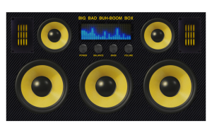

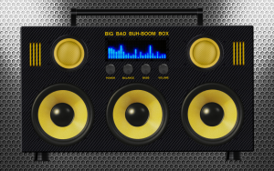

my carbon fiber 3x8" "BIG BAD BUH-BOOM BOX" design
funktoon
OK... i took a break from tweaking my Tecsonic J-2 design which i'm going to redo one more time from scratch to fix a few minor issues as well as get a new graphics layer for upcoming color changes, so i've been working on this "from scratch" design that'd be what i'd build for myself if i ever wanted another boombox. some might find its simplicity boring or the yellow over black bumblebee color scheme tacky, but the point was to match the yellow of the planar tweeters better. they serve several purposes... in theory, they're a lot lighter than domes with big heavy magnets, they're efficient and easier on batteries, they're large, so they should move more air than domes, and planars are more hifi sounding as they can extend much higher than regular tweeters with more speed to boot, so everything was built around those.
the carbon fiber box would be both light and extra strong, tri-amping with class D & LiOn batteries would be lighter & more efficient, and the box only has the controls needed with no un-necessary fluff. i like the design after figuring out to color key the graphics to the speakers... it's my kind of minimalist design. the 3 x 8" woofers would be subs only, probably at 20-100Hz with separate amps for the 5 1/4" mids and tweeters. the design is based around HiVi kevlar woofers which have those annoying rear mount gaskets, like PA woofers that no-one ever uses and are an eyesore to me. mounting the cones inside solves that problem as well as allows closer spacing of the mids & tweeters with some overlap. the wider spacing of the subs is to accommodate both the outer rings along with internal bracing to minimize box resonance.
the original plan was to mount extra long ports inside the sides, but if i actually built this box, i'd probably add feet with downward firing ports which should give a slight bass boost.
there's no handle for the box... the best way to carry one this big and heavy with all those big magnet drivers, as far as i'm concerned, is putting a couple guitar strap nuts on the sides on top for shoulder slinging.
whether or not the visuals appeal to you, this would be a serious piece of hi-fi kit... especially with 200w (3dB headroom) for the three subs... probably with extra EQ to make them flatter without the bass boost, 50w each for the mids and 25wpc fo the tweeters. that's a fair amount of power with both an extra woofer and extra large mids and tweeters to move a lot of air. in theory, it should be able to blow any box ever made away for both SQ & SPL.
it'd also be crazy expensive to build, just for the carbon fiber without the added CNC machining, but it'd also be "the best ever", in my opinion... maybe only intimidated by 10" rexels, though i bet those only have 2x50w amps, if that.
whatever you do... don't drool on the new art

Jorge
Just a thought: how difficult it would be to incorporate cassette mechanism into such beauty? You know, to make it into a "real" bbox, and to build a wall with bumpboxx offerings...
Mechanism scavenged from JVC or National, those seem real nice...
Totally Love the idea of Kevlar drivers, look soo hi-end I want to buy it already!!! :-)

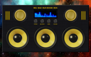

the reason i popped in was to share the improved version that gets rid of the plastic tweeter mount and uses dynavox 5 1/2s for midbass. those are some of the sexiest speakers ever as far as i'm concerned, and the giant dust cap ties in with the "big & bad" theme, makes them look more like dome mids, and would better time align with the planars.

My understanding is that Bumpboxx dudes played the best brains here, then went solo.... I really like what I see here because of its planar tweeters: very forgiving, analog-sounding thingies with the technology really scaling down price-wise from Stax of the 70-ies onto the affordable side for guys on the budget! But not a single bbox with such tweeters, I wonder why this never ever happened?? Too much power draw from batteries?
Now that you mentioned it, Top-loader mechanism looks like an idea for such bbox!
With that speaker set up and a few class t amps and a good preamp with planer tweeters and Edge wound Kevlar mids. This f****** thing would smoke a bummboxx into next week .
No CD, no tape, radio, no anything. No handle. At least blimpboxx is real. I don't do fantasy football and I certainly don't do fantasy boombox. Besides, as for the no no no issue, I seen that movie before, and it was a snoozer.

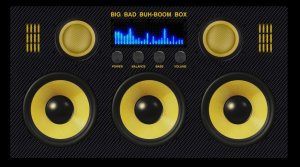

[SIZE=14pt]just a few minor revisions...[/SIZE]
[SIZE=14pt]i beveled the edges... not fun carrying a box with sharp edges that are probably more damage prone too. i didn't do the corners though... maybe in a final version. they were too fiddly to bother with at 4 in the morning.[/SIZE]
[SIZE=14pt]i also need to add feet for the bottom ports and though of adding a hollow aluminum tube rigid handle on top for when straps aren't an option. [/SIZE]
[SIZE=14pt]i dropped the woofers to be able to push the dynavox mids out more, along with the tweeters for the widest stereo image possible[/SIZE]
[SIZE=14pt]seeing i switch to mounting the tweeters inside, there's no reason to keep the old grill style. i REALLY like the look of the simplified tweeter grills. that's been the overall goal of this design... KISS (aka "keep it simple, stupid"). elegant simplicity.[/SIZE]
[SIZE=14pt]if i was building a boombox... this is what it's look like[/SIZE]

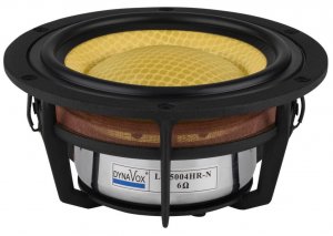

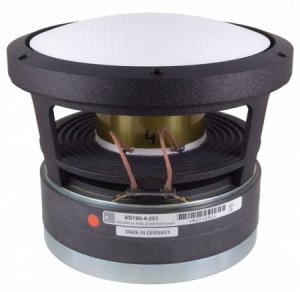

[SIZE=14pt]fanally, here's a better look at those gorgeous dynavox 5.5s. those are some huge & heavy magnets! imagine this box with an A/C transformer, discrete electronics, mechanicals, class A/B amps with heatsinks, and a dozen D cells![/SIZE]
[SIZE=14pt]the box could be re-done with 6 1/2" mids to move more midbass air, but they'd force the box to be taller which doesn't look right & would have slightly sloppier mids than the 5.5s. besides, they look "just right" next to the planars. i just love the looks of the L/R speakers. accuton makes some gorgeous 8" white honeycomb dome woofers, but they look like they weigh 50 pounds each. that, & they're $900 each, but they'd look awesome in a pair of mini towers, no?[/SIZE]

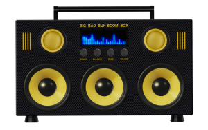

anyways, haters aside, here's the "final revision" of the box where i added feet and a fixed handle. for me, i'd drop the handle because guitar straps are so much better and carrying a heavy box would throw my back out. heck, even carrying a 12 pack of soda to the counter makes my back act up. i'm an amputee and ALWAYS carry 10 more pounds on my right side, so i carry anything heavy in a gym bag slung to my stump side.
because i can't afford to build a box, i can dream, and as an artist, i can at least simulate the dream. maybe i might inspire others to "think outside the box" (pun intended) and use my ideas in their designs.

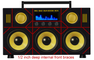

with that out of the way, i was just popping by to post the front baffle bracing scheme i came up with. while i'm not a boombox expert, i have a fairly decent grasp of basic acoustics & engineering. note how i tried to minimize the surface area that could potentially resonate whilst keeping weight ALMOST to a minimum. (drilled out braces would be even lighter) in thinking about the design and someone's comment about mass loading (yeah... i lean towards that too and would NEVER buy a rega turntable or speakers that fail the knuckle test LOL), i neglected to point out that the drivers themselves provide mass loading that would help dampen resonances provided the front baffle is rigid enough, and i think with that much 90 degree bracing... the front baffle should be easily strong enough to stand, maybe even jump on and would be way more rigid than soft plastics. ever pick a carbon fiber bike up?
if, down the road, my other biz takes off, i would revisit this design and produce it commercially, though it would be for a very small niche market due to the high cost of carbon fiber & LiOn batteries. I'm sure a FEW people with the means would love to own the "highest fidelity boombox ever made". the design combines my love for boomboxes as TOOLS to fight the evils of evil music (heavy metal, gansta, industrial etc.) & UNITE people from all cultures with positive & upbeat (read REAL hip-hop) dance music. we were all getting along in the 80s and hip-hop was a part of that. combine that with my love for high fidelity, & my love of design & engineering, and THAT's why i made this. it isn't for everyone here, and that's fine... but i'll bet a nickel i'm not the only one here who buys copies of absolute sound or stereophile and reads reviews for gear i'll never be able to afford. the same goes for magazines like road & track etc. just because the box doesn't exist yet and s unobtanium doesn't mean some might find it an interesting break from consumer grade off the shelf gear.
