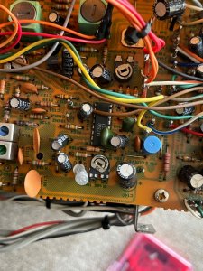

Thanks Reli! There are two record bars for this Marantz and will clean it again. I and rotated the trimmer slightly to either side and reset it to the original position. This is what I did to two trimmers sitting next to each other. I need to identify the correct VR2 pot for the stereo LRD and try to adjust it tuning to a powerful FM stereo station. Thanks!
This is from the service manual. R166 is the one you need for getting the stereo light back on. I rarely touch the other one, it's basically just left/right balance
Thanks so much Reli! I burned my eyes a lot in one schematics pic and was unable to find the R168. Yes, I will leave the 168 alone and try to adjust with R166.
Today I tried adjusting the R166 trimmer setting at a strong station on FM and the LED never light up. I repeated the process tuning at other stations and went all the way adjusting that 10K trimmer R166 without no success. Now my concerns is that if the LED has gone bad for some reason. It was working well initially on many FM stations before, then stopped working and then again worked for a while before it stopped.
I was wondering how I can check if the LED has gone bad? I don't know the operating voltage and current for it. Is there a way to check on the LED leads.
If I pull gently on one of the leads on the non working right VU meter, the meter comes alive but won't work when I leave it. The meter tip deflects like a mm most of the time at the mid point area on the scale where it is partially stuck. Seems like there is some obstruction for the free movement. I need to take the front face Al plate for removing the VU meters and play on the screw head of the VU meter suspension. For removing the front Al plate I might have to disconnect the microphone leads, or the glued microphones on the Al face.
Cleaned the two record bars so well! So also the function switch and all switches.
