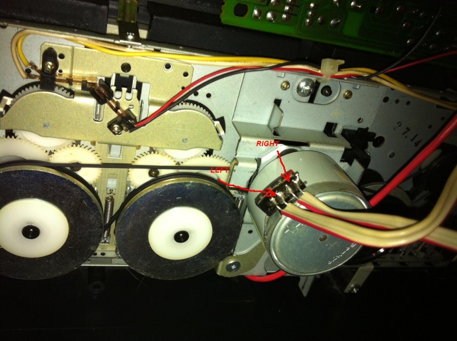

Hi guys, I finally picked up a 975 in great condition but the tape decks weren't working. On further inspection inside I found that the drive motor wasn't connected. I have no problems soldering the wires back into place, but I'm not exactly sure which ones go where. If anyone could provide a picture of the 975 all hooked up correctly I would be greatly appreciative. :thumbsup: :thumbsup: :thumbsup: :thumbsup:

Here is a picture :-D wires go lef and right :thumbsup:
