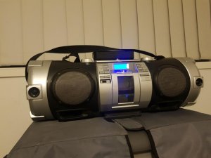

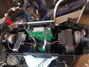

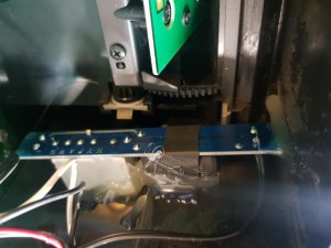

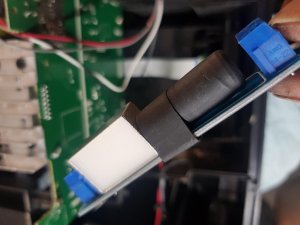

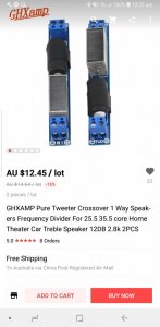

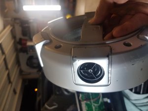

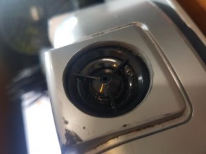

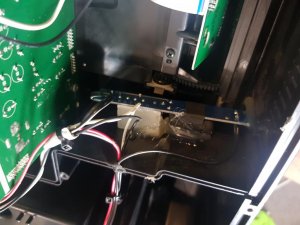

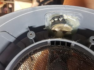

Added tweeters into the outer SUBs casing I couldn't hide them. Bought tweeter crossovers online from AliExpress they are Inductance coil and capacitor boards. Removed the binding posts and soldered straight to the board. Removed the capacitor from the tweeters. Tweeters came from an 04 Nissan Maxima OEM. As you can see it took some doing but I got there and it sounds absolutely amazing. It's now up there with my Harmon Kardon GO PLAY. Bluetooth was easy just a 30pin adapter from eBay, I'm in love with my JVC. Thanks for looking.
