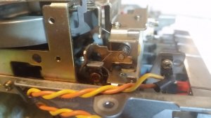

a JVC RC-M70 with a AUTOSTOP problem after changing the belt of the same size.
Ø = 72mm x W = 3.5mm x TK = 0.5mm TL = 226.2mm BF = 113.1mm , Flat Belt
It starts to read, advances and returns normally and after a few seconds, the mechanism starts to click endlessly.
I have a doubt about the solenoid and peripheral springs see attachments
Would you have a diagnosis and solution please

I have similar problem sometimes while playing cassette and always at the end when auto-stopp have to stop the motor.
docs
In my experience, auto stop has usually been clutch pads being worn and potentially belt size slightly out. But you have to make sure pivot posts are clean and gunk free along with general deck degreasing.

Hello, excuse me for delay.
I resolved by changing the flat belt with good size : FBS9.6 Belt FRM9.6 Flat Belt, bought from KP Components Inc.
Hope it helps U
