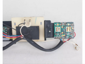

Hello everyone. I recently obtained a JVC RC-838 that was by no means in perfect condition. Ive been doing lots of work to it by cleaning the switches and rebuilding the sliders but I'm still left with a couple of nagging problems.
First big thing is only the right level meter will work when you want to have the VU meters represent how much sound is going to the speakers. I know that the left VU meter is not faulty because when i press down the battery check switch the left meter will flick over but once again it will not do anything when the volume is high enough so that it should move around.
I also seem to have a small issue with the power switch but I'm not sure if it is really a problem or not. When I'm in the radio mode and i flick the power switch off i get a small pop threw the speakers right before it turns off. When i turn it back on i get a pop but not as loud. I believe when i turn the boombox off i can see the right vu meter move a little bit witch would mean that some signal is being amplified when the unit is turned off.
