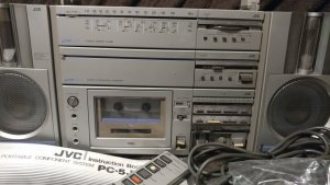

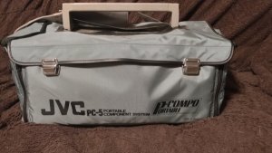

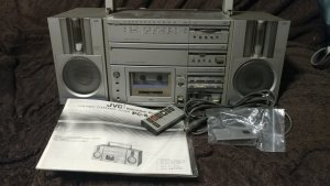

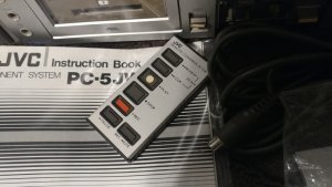

Found a JVC PC-5 with original owner's manual, carry bag, and wired remote. Unit is in fairly good condition with some scratches on top, and the small door on the cassette deck has a broken tab.
Nice, inexpensive ($150) addition to my PC-11 and Silver ST-858.

See the woofers were replaced with whizzer cones , the original woofers were notorious for foam surround rot. Refoamed a system I had a few years back. Great sounding unit and great find!
Reactions: floyd
Radio raheem
Requiem Æternam
refoamed several of these, takes about 20 min, cracking box, watch the bottom flap they break of so easily, congrats
